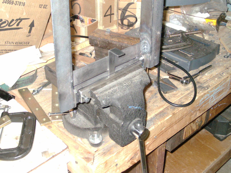

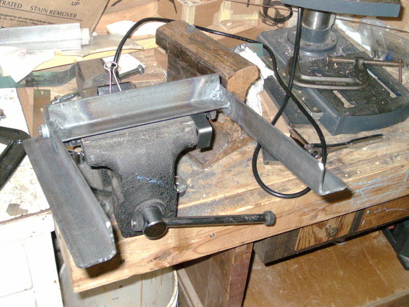

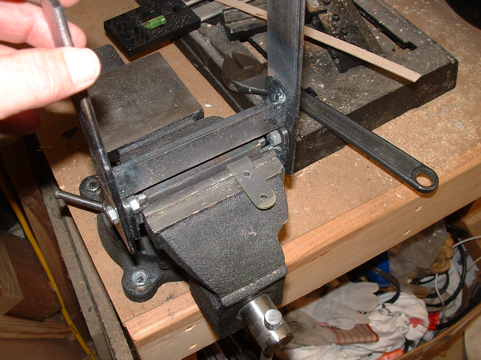

I copied this vice-mounted brake from some pictures that Jim Markle sent me.  This works so much better then pounding the fittings with a hammer and a block of wood.
Here are Jim's pictures:
bending2003_0108_174816AA.JPG (762697 bytes)bending2003_0108_174834AA.JPG (762523 bytes)bending2003_0108_174423AA.JPG (786043 bytes)bending2003_0108_174438AA.JPG (790705 bytes)bending2003_0108_174511AA.JPG (793014 bytes)bending2003_0108_174515AA.JPG (778064 bytes)bending2003_0108_174611AA.JPG (799532 bytes)bending2003_0108_174705AA.JPG (792697 bytes)

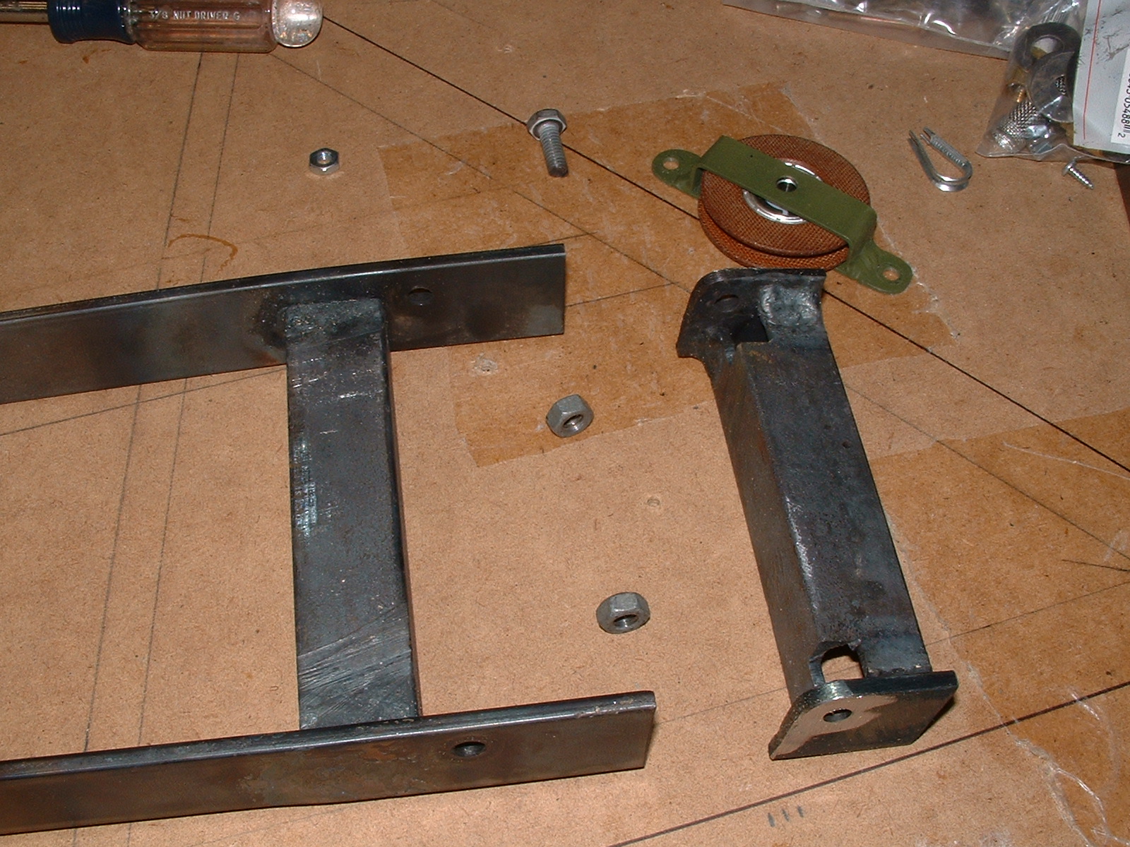

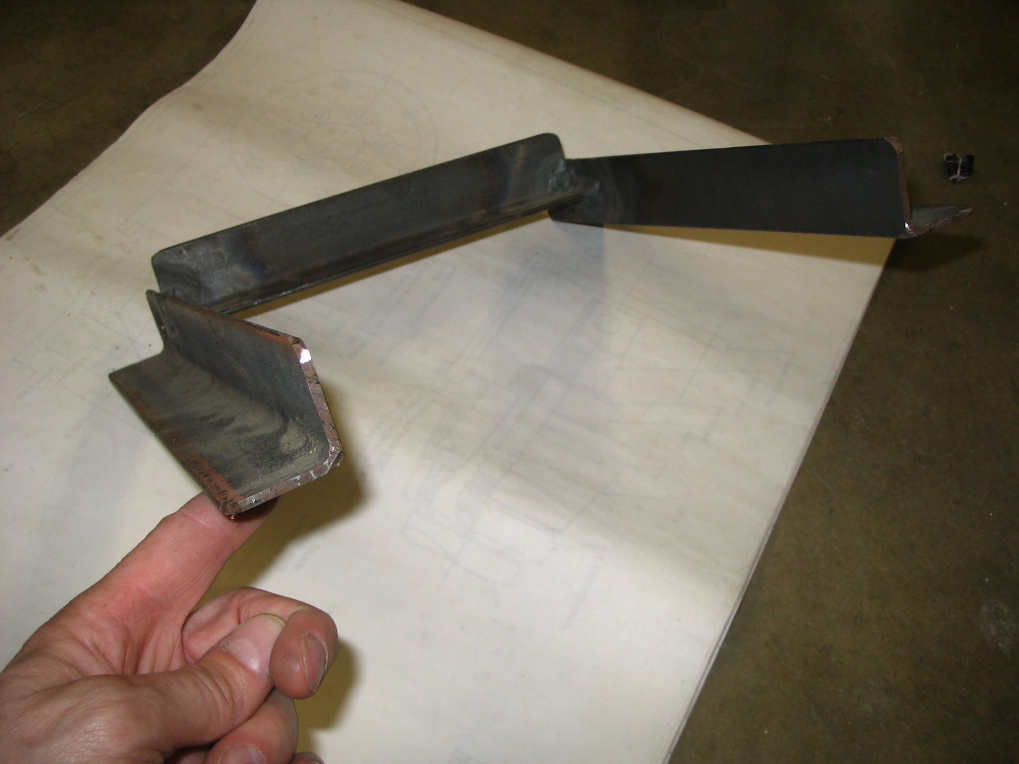

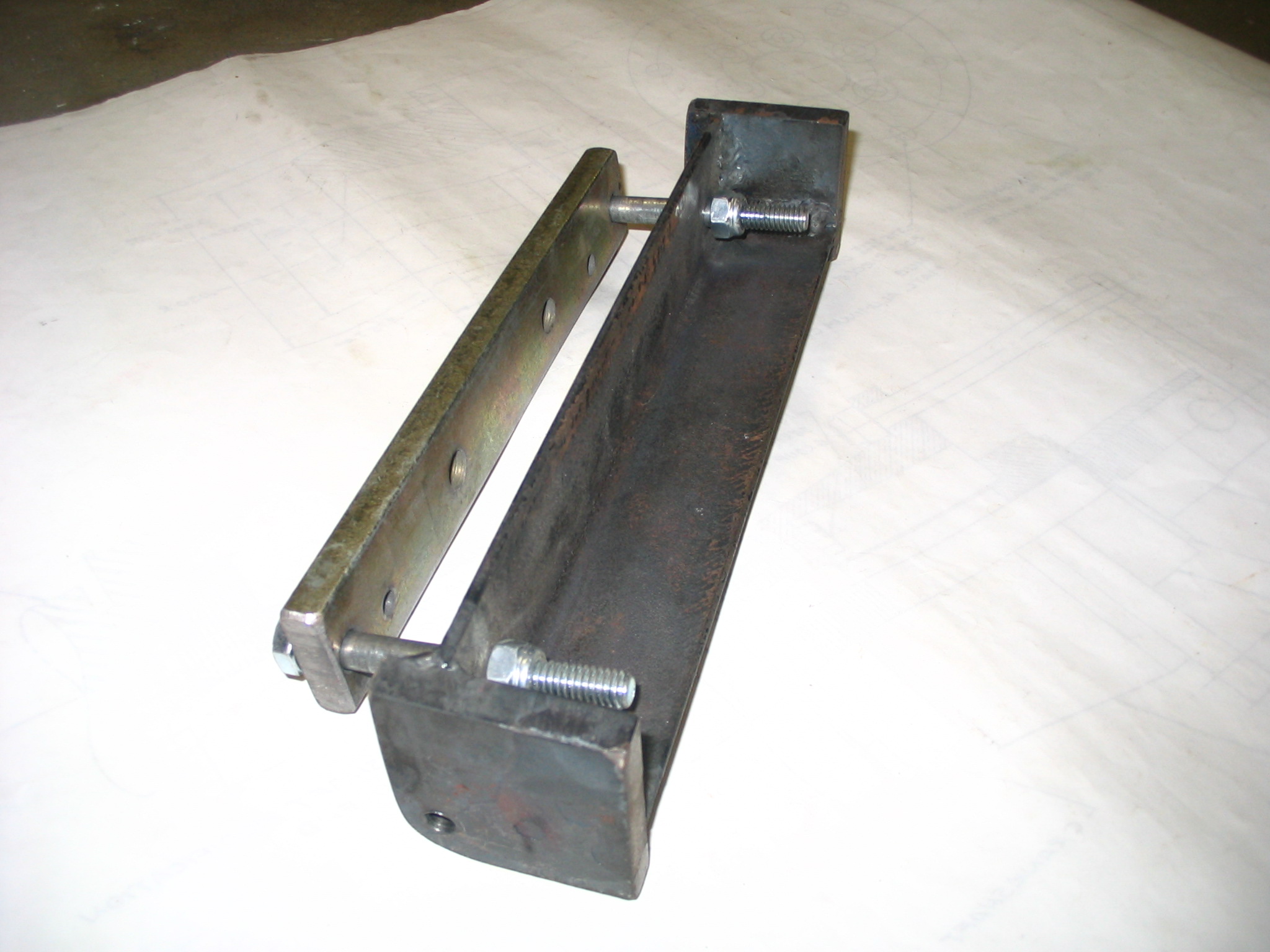

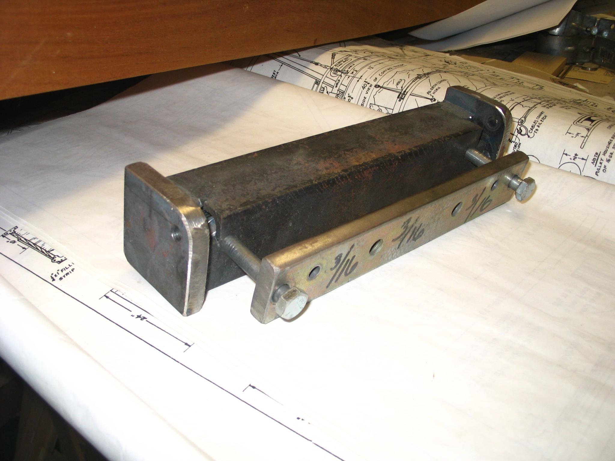

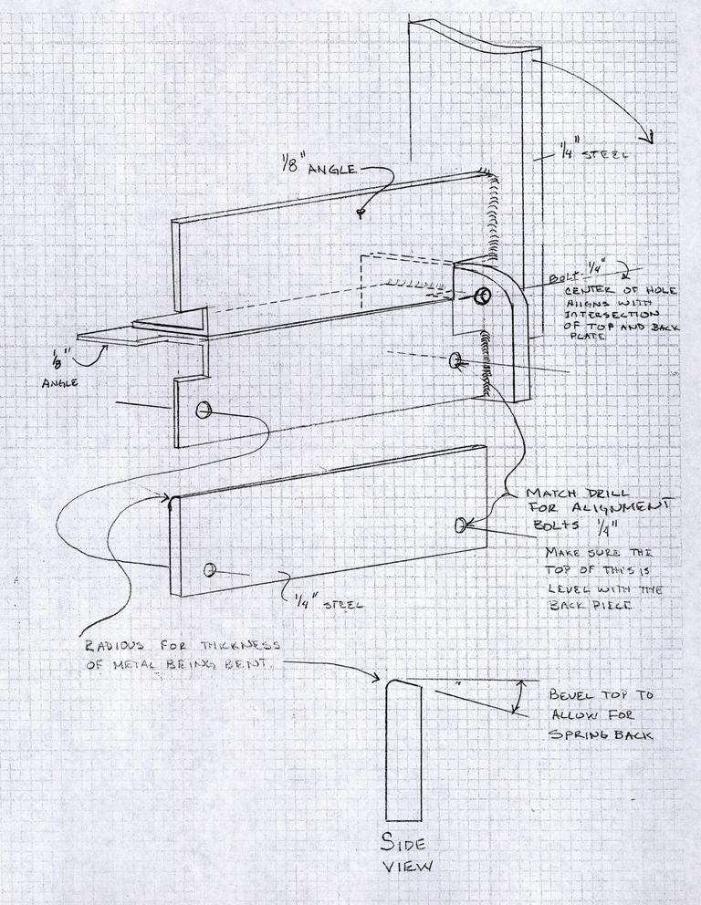

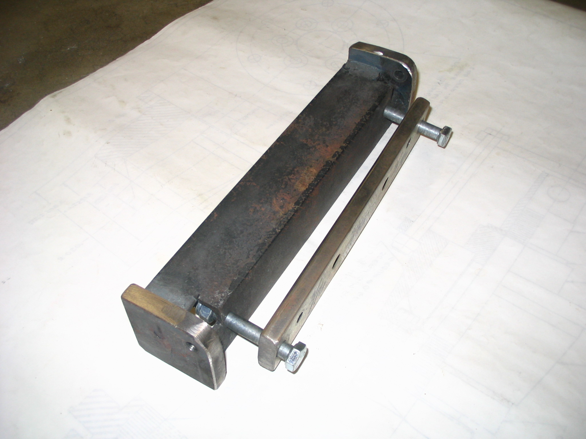

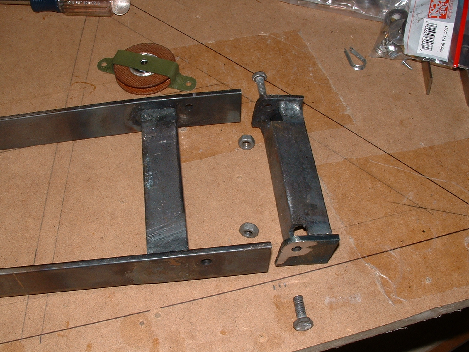

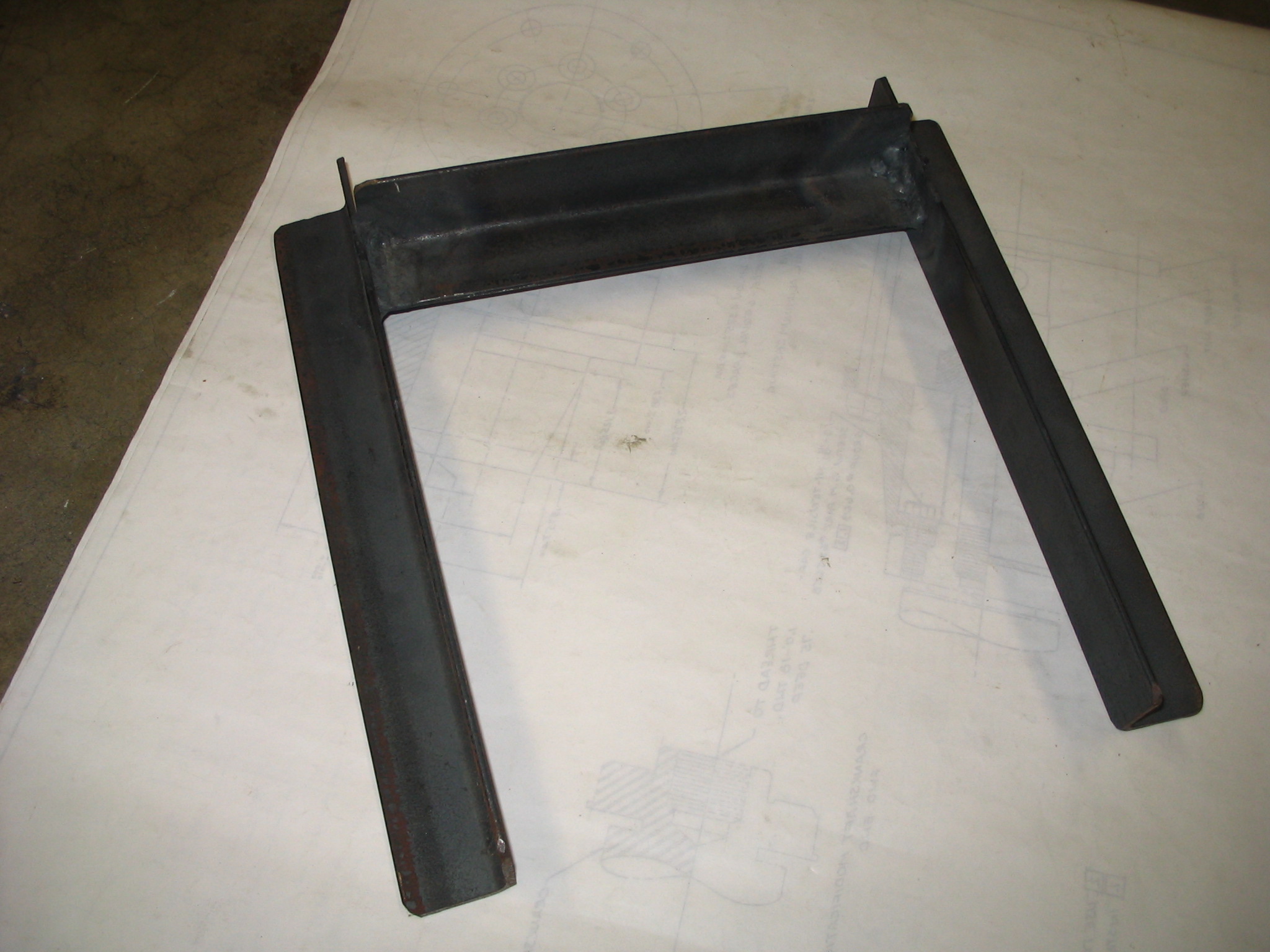

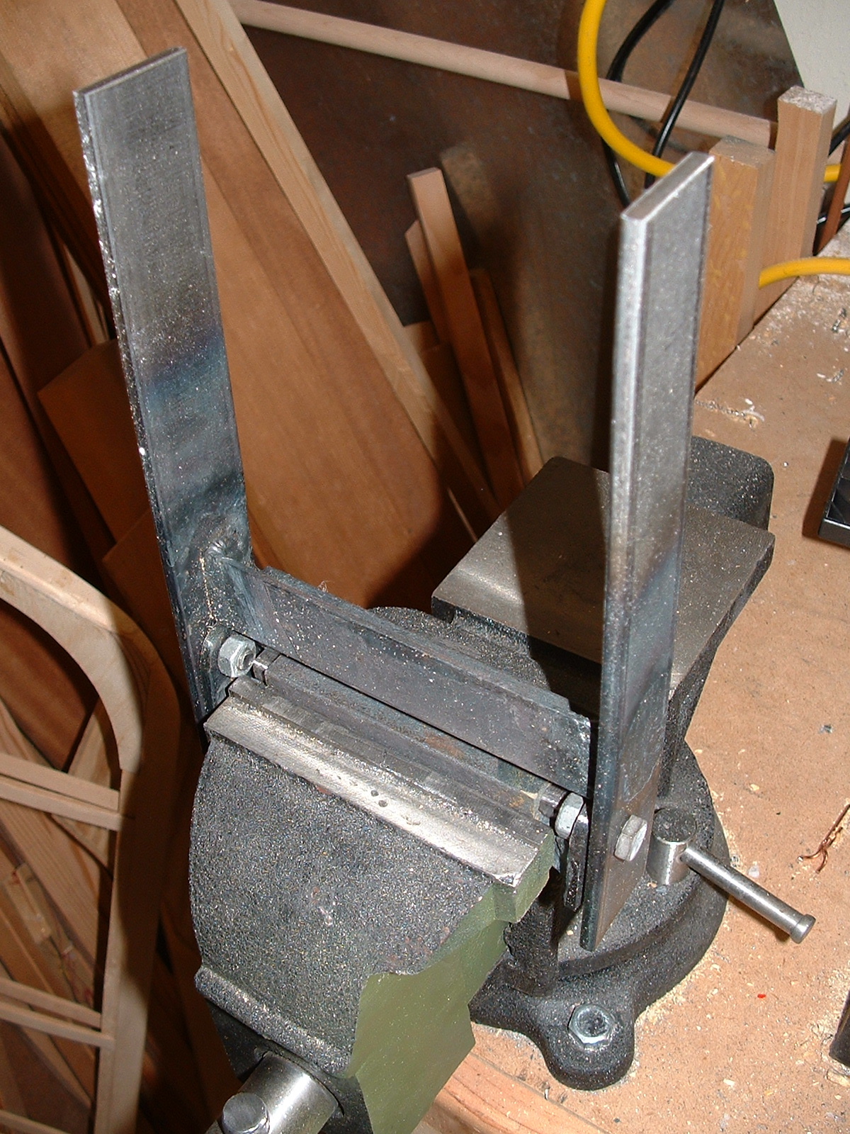

When I made mine, I added some alignment bolts to hold the face and back jaws  together while inserting the metal.   I had trouble welding the ¼” steel, so I built mine using some angle iron from an old bed frame I had lying around.   You will need to make several front jaws with different radiuses to correspond to the bend radius that you want to use.
IMG_2665.JPG (582059 bytes)IMG_2666.JPG (470134 bytes)IMG_2667.JPG (499222 bytes)IMG_2669.JPG (542341 bytes)IMG_2670.JPG (528865 bytes)Bend3.jpg (159526 bytes)

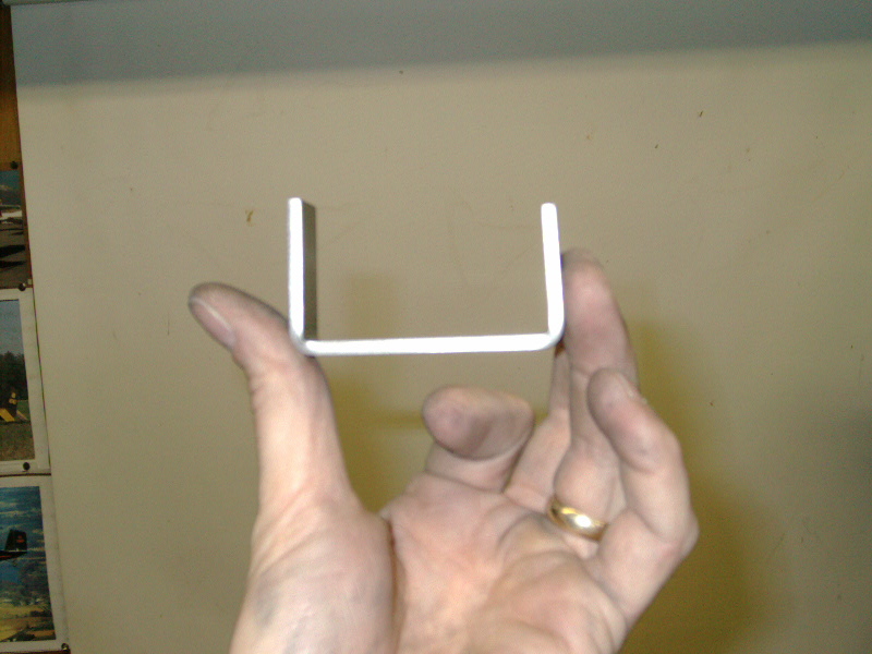

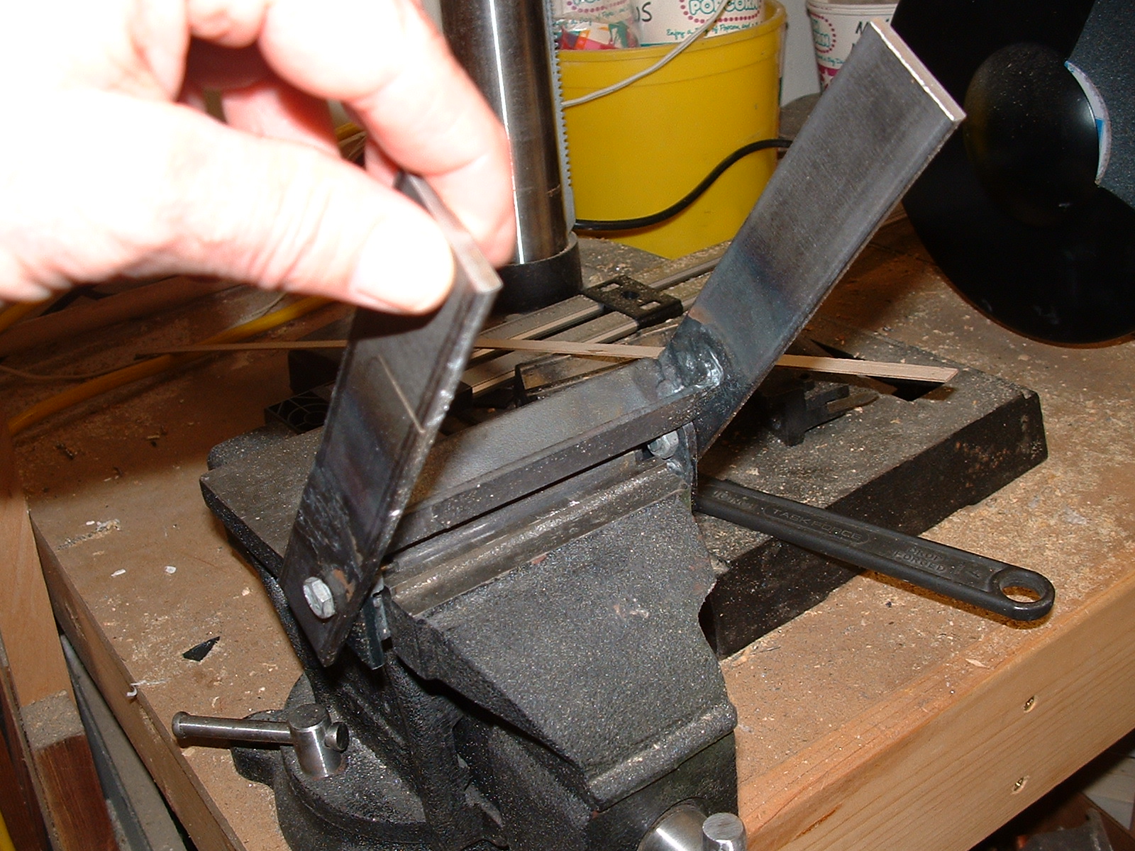

For 4130, the minimum bend radius is 1 x thickness (1T). I try use about 2T or a radius closest to a front jaw that I have already made.  No need to build to minimum standards.  I have bent up to 1/8" 4130 steel and it has worked great (See pictures below).
To use it, draw a sight line (or reference line) on your fittings where you want the bend to be.  I usually use a small triangle along the top of the front jaw to verify the sight line is parallel with the top of the jaw. Tighten the vice and pull down on the handle.
You can calculate the bend allowance and sight line using the formula found in Tony Bengale's books or on the web. Whenever possible, just leave the two ends long and trim after bending.
