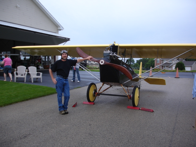

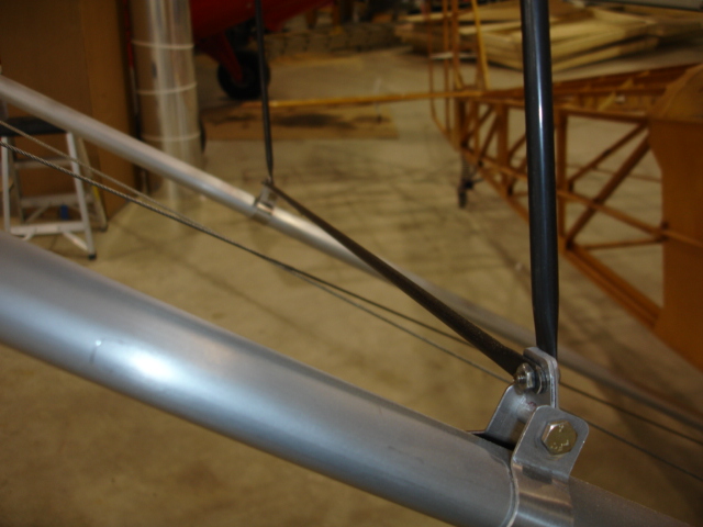

I used the alum struts like Larry Williams. The aluminum insert is 7075 aluminum that
I got from Mcmastercarr.com. The bottom fitting is the same 7075 insert, that
I tapped for J-3 forked wing strut fitting (ACS or Wag Aero?). Inserts are bolted
through the strut with 1/4" bolts. Dan Helsper
For my cowling I used .032 thick 3003. Worked very well. I
hammered in some bumps and louvers very easily. The stuff is sufficiently soft
and has held up very well so far.
