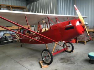

For years, I've told people that I expected to finish building my Pietenpol on Tuesday. I was
wrong. I finished a day early.
After a mere 20 years and 2 months (most of it spent with no progress being made), today I
received an Airworthiness Certificate on NX313KB.
The lesson here is to keep plugging away. Eventually there will be no more items on the to-do
list.
Taxi testing to commence later this week.
