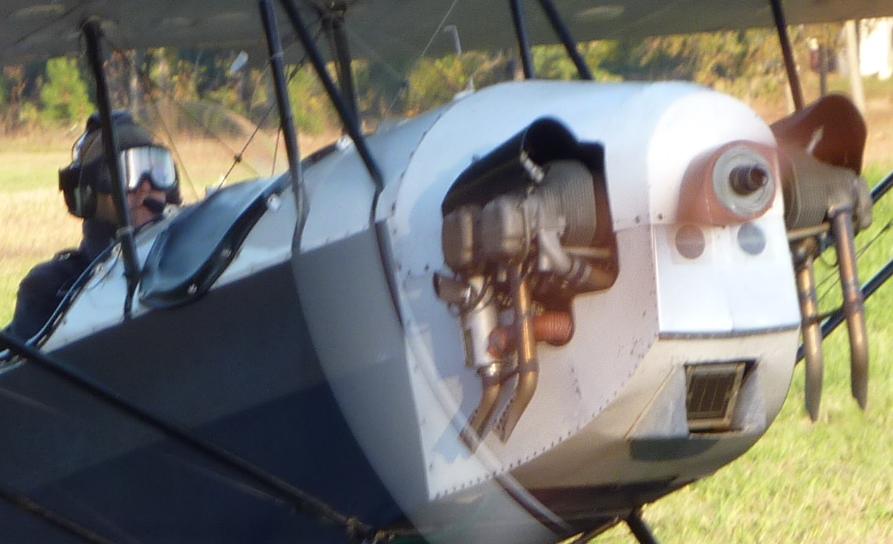

Our Piet was originally built in 1976 by W.D. Hartway in upstate New York. It may have originally been a shop class project. The workmanship is very good - all joints tight, everything true. The plane has always been hangared; fabric and paint are still in top shape. It has a three-piece wing, split-axle gear, unknown motorcycle wheels with brakes from same. The original A65 only had about 350 hrs SMOH, but had low oil pressure. We've now replaced it with a C-75. We've just re-plumbed the fuel system so now the wing (12 gal) and fuselage tank (14 gal) are useable. We did it similar to an Aeronca system in which the wing tank refills the fuselage tank.

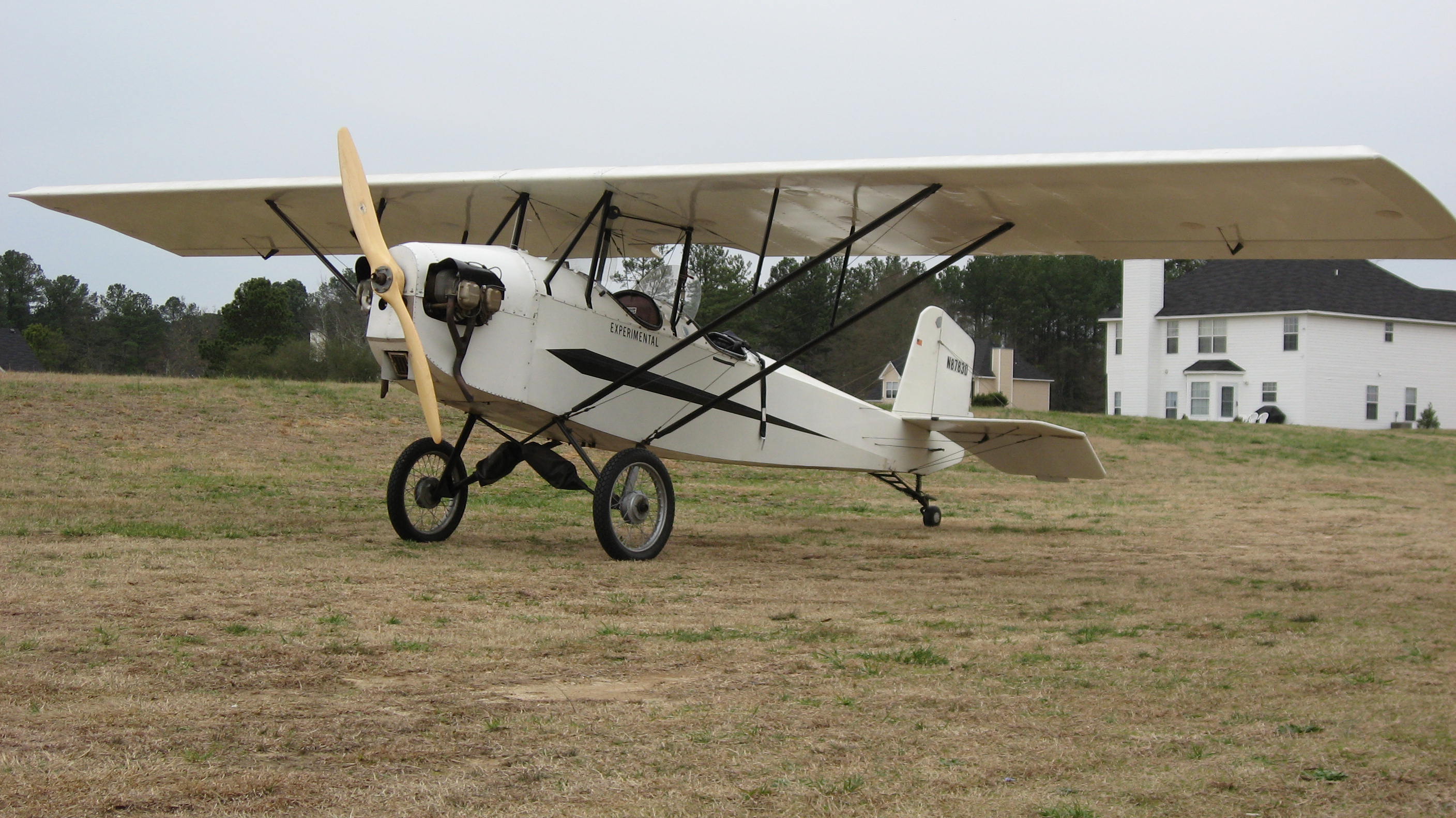

After the repair it's looking better then ever. (Got to love that propeller!)
