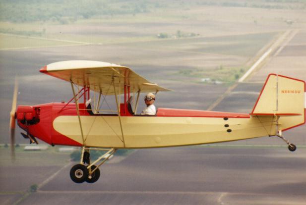

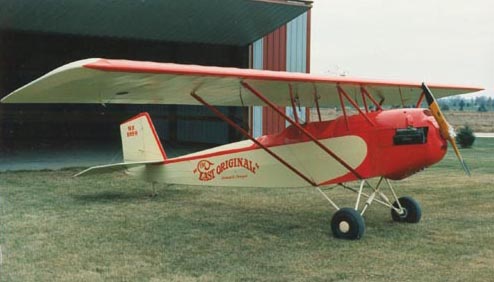

What is the difference between the Pietenpol Air Camper and the Grega GN-1 Aircamper? Basically the GN-1 is a modified Pietenpol that looks very similar to a Pietenpol when finished. However, anyone familiar with both designs can likely tell the difference.
Pietenpol GN-1 I’m no expert on the GN-1 design because I am building a Pietenpol Air Camper, but I do have the plans for the GN-1 so I will try to list some of the differences.
There are more, but like I said, I’m not building a GN-1. One last thing …, note the difference in the name. A Pietenpol is called an Air Camper while the Grega GN-1 is an Aircamper. Note the Pietenpol is two words.

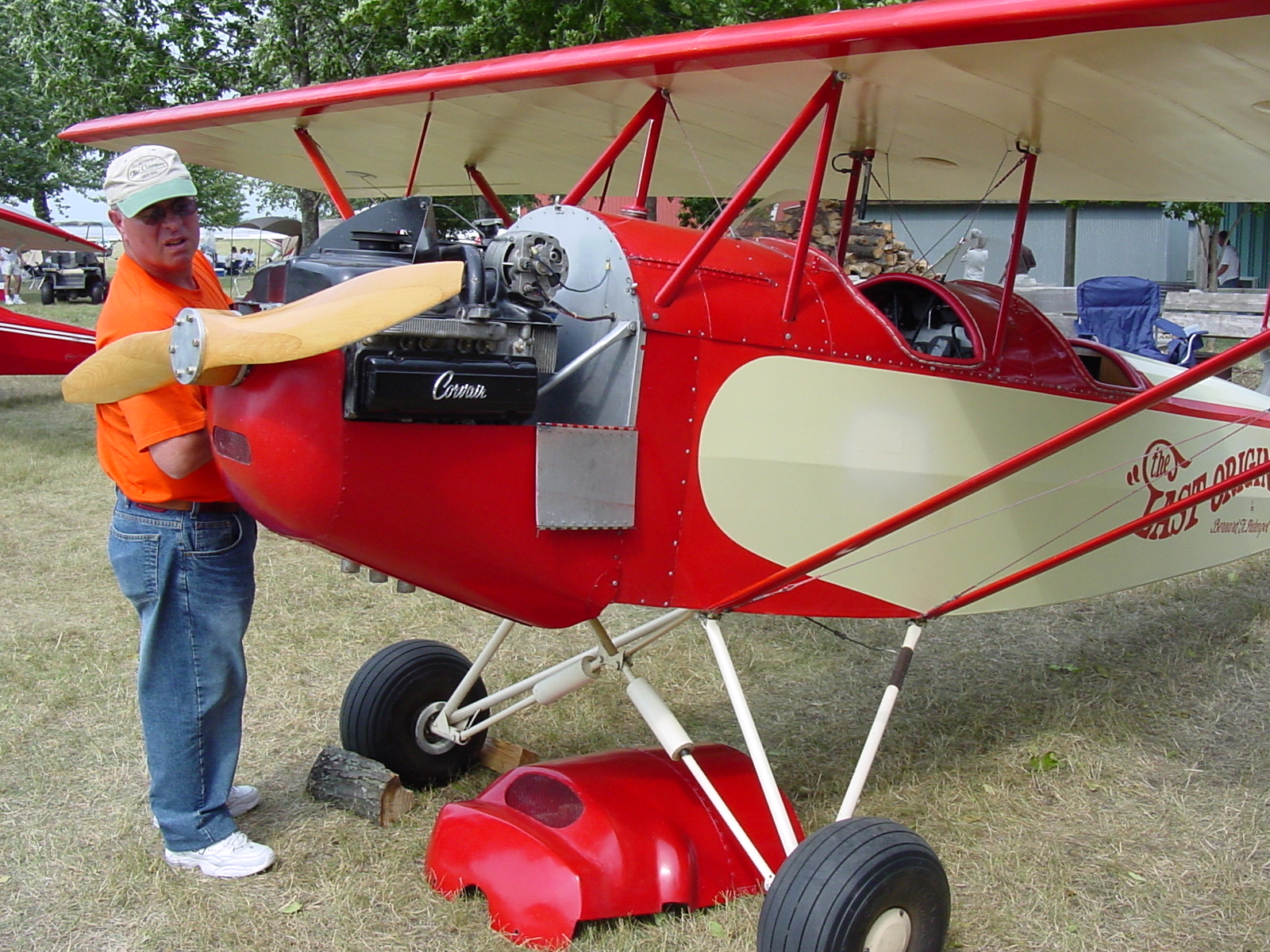

I don’t want to use the Ford Model "A" engine. Can I use something else? Yes, it’s your plane. Use what ever engine you want. Ok, that’s probably too short of an answer. You can use any engine you want. However, some engines are too light in weight, such as the VW and Rotax engines. Remember that most Air Campers, without the Ford engine, turn out to be tail heavy (aft CG) when the wing support struts are installed vertically. If you replace the Ford a lighter weight engine, you are bound to be tail heavy unless you compensate for it (See question below). The most common alternative engines on an Air Camper are the small, A-65 to 0-200 size, aircraft engines (probably the only plane where you can call an aircraft engine an alternative engine). The Corvair engine is another popular choice and one which Mr. Pietenpol designed. The Subaru engine as well as other auto conversions have been used successfully. Some even have a big old radial engine on the nose... man that looks good. (This is the engine I would use if I could afford one). By the way, you can purchase plans for the Corvair and Continental motor mounts from Andrew Pietenpol.
