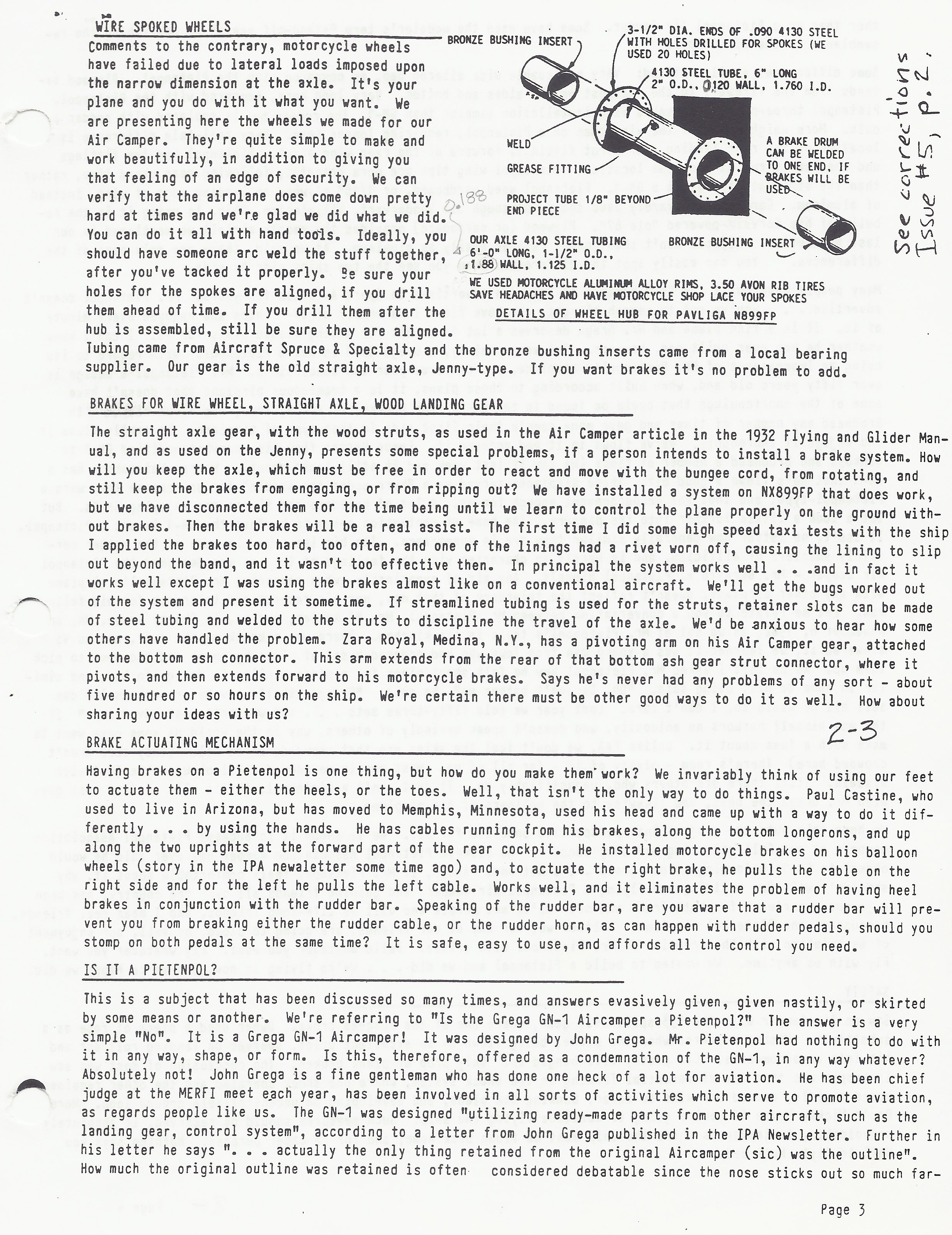

Drawings of home built hubs
Frank Pavliga drawing
Drawing based on Ken Pekins Hubs

This info on wire wheels first appeared in Kitplanes, March of 1990 on pages 36 - 38. Grant MacLaren included it in the BPA
newsletter back in June '94 with further updates in Jan '95.
"Each hub's basic component is a piece of 2" O.D. 4130 steel tube, 6" long, with a wall thickness of .120". The disks to which the
spokes are terminated at the hub are also made of 4130. They are 3.5" in diameter, .090" thick, with their centers cut out to fit snugly
over the steel tube. Each wheel has forty spokes so twenty spoke holes are drilled in each disk. The diameter of these holes is determined
by the size of spokes used on the wheels. The hub's spoke holes are equally spaced around a circle 3" in diameter, concentric with the disk.
With the tubes and disks finished to this stage, they are joined by heli-arc welding. The outer faces of the disks are located one-half inch back
from the ends of the 6" long tubes. It is very important that the disks be welded with their spoke holes alternately spaced. In other words, the
 disks do not have their spoke holes aligned. The center of a hole in one disk is half way between the center of two holes in the wheel's other
disk.  When the disks have been properly located and welded to the tubes, the hubs are chucked in a lathe, then carefully bored clean and
round to receive pressed-in bushings. The bushings are bronze, at least one inch long, and made for a .001" to .002" interference fit in the tubes.
A bushing is then pressed into each end of each tube. The insides of the installed and bored bushings should have about a .002" to .003"
running fit on the axle."
Next is to add brass grease fittings; "...they're readily available from any good Ford restorer's parts house. Snyder's Antique Auto Parts,

Ken- I machined some 4" diameter x 1/8" thick stainless steel for the hub ends, then
welded those onto a 6" long s/s tube.  I forget the wall thickness of the tube.
The axle as I recall was 0.22" thick 4130 chromolly from Dillsburg Aero in Dillsburg
PA.  717-432-4589. 1.5" o.d. with standard axle nuts and cotter pinned. Flanged oil-lite sintered
bronze bushings to fit the hubs and axle.  (visit Bearings, Inc. now called Applied
Industrial Technologies or your local bearing dealer near home)  Made my gear
wider than plans....forget exactly.  Maybe 4" wider ?    I used 40 spoke aluminum
rims 19" x 3.5 found after going to 5 to 8 motorcycle shops all over northern Ohio
They were undrilled.   I would go the same route again.  One note- for the wide a/c hubs use all 'inner' spokes,
not the inner/outer alternating method seen on some bikes.  This avoids the 'root' of the spoke from rubbing or
 bending over your flange from the outside.  If you make them all 'inner' spokes this won't create a potential problem.
 Took lots of measurements and photos of how other guys did theirs and made my own conclusions. So far, so good :))
I took the rims and hub to the local cycle shop and he faxed my dimensions out to Buchanan’s Frame Shop in CA
and they rolled 80 stainless 8 gauge spokes for my application.   My Piet weighs probably ½ what a Goldwing does. at
632 lbs.   I've seen many guys use stock motorcycle wheels and brakes with no problems, but have been told that wider hubs
 are the wiser choice for resisting side loads, ground loops and your basic 'fold them over like an inside-out umbrella mode'.

Ken- I have the size hole I drilled at home on a sketch.  I'm sure it was just barely enough to get the straight
end of the spoke thru.  I also countersunk the holes on the outside face of the hubs to conform with the countersunk
 shape of the spoke end.

I'm going to burglarize your conversation here, as I have gone thru the process of building some "tall" wheels.
It really isn't all that difficult. Brent- Warren's description is very similar to my story.  (but I'll bore you with mine anyway....:)
I searched many, many motorcycle shops to find 19" aluminum rims with 40 spoke holes as opposed to the more common 32
I think it is now. (ps- you can use 17, 18, ....21" wheels.) I found a pair of Borranni made in Italy 19 x 3.5 undrilled alum. rims for
$ 40 each.  I followed a similar description found in one of the BPA newsletters by Howard Henderson or Grant about Howard on
 how to fabricate hubs.  I welded up two stainless 1/8" thick discs to a stainless tube 6" wide  and pressed in two oilite impregnated
flanged bushings from Bearings Incorporated.  (now called something else)  I took the hubs and rims back to the cycle shop with a
 sketch of both.  The owner faxed my sketch (with all my dimensions on there) to Buchannen's Cycle shop in CA.  I specified
8 or 9 gauge stainless spokes similar to Warren.
You can get steel, chromed, or stainless...spokes.   A dangerous thing is to make your own spokes by cutting down used spokes
and threading them.  Cycle threads are 'rolled' into the material, not cut.  This process avoids the weak stress risers you get when
you cut threads by hand.   It wasn't cheap to have spokes made but I've bashed that plane in pretty good 2 or three times without
a hint of ill effect.  (except on my passengers, of course :)) Try not to cheeze-out on your axle wall thickness either...I forget  what
it is, but it feels too heavy to your senses.  (.17 or .20"?)   Once my spokes arrived the cycle shop couldn't use their lacing jig to
do my wide 6" hubs so he gave me some pointers and home I went.  Buchannen's provides you with a thread lubricant,  and specific
instructions on some items, but the rest was my problem.  It took about 2 hours per wheel to lace and true them up. It was pretty
much trial and error with the help of a dial indicator I borrowed from work one eve.  Actually your eye is a super natural dial indicator
 too.  Back to the cycle shop and they put a big flat wide black rubber band around the rim base to protect the inner tube from the
protruding threads poking thru.  On advice from the cycle shop I ground all of my threads down to the nipple on that side and put duct
tape over each one before the rubber 'band' when on.  Nice and smooth.  More work, but less headaches later.  Then they mounted
the tires and tubes and off I went.

Issue #45 of the BPA Newsletter has the article (reprinted from
March 1990 Kitplanes) on brakeless wire wheels.
It calls for 2" X .120 4130 tubing for the hub and flanges cut from .090 4130 3.5" in diameter. Bushings are
 turned for a press fit in the hub and a running fit on the 1.5" axel.
McMaster-Carr sells oilite bushings the correct size for a couple of bucks each.
The hub tubes are 6" long and the outside face of the flange is set back 1/2" from the end of the tubes.
The flanges are drilled to accommodate 40 spokes per wheel.
I found that motorcycle rims with 36 spokes were far more common.
I did find 40 spoke rims at the bone yard. Look for rims from Honda Goldwings or the big
Kawasaki’s.  Spokes are from Buchanan's. Search for their website.
This was a time consuming project that cost approx. $450.00 but when they were finished it was very satisfying.
