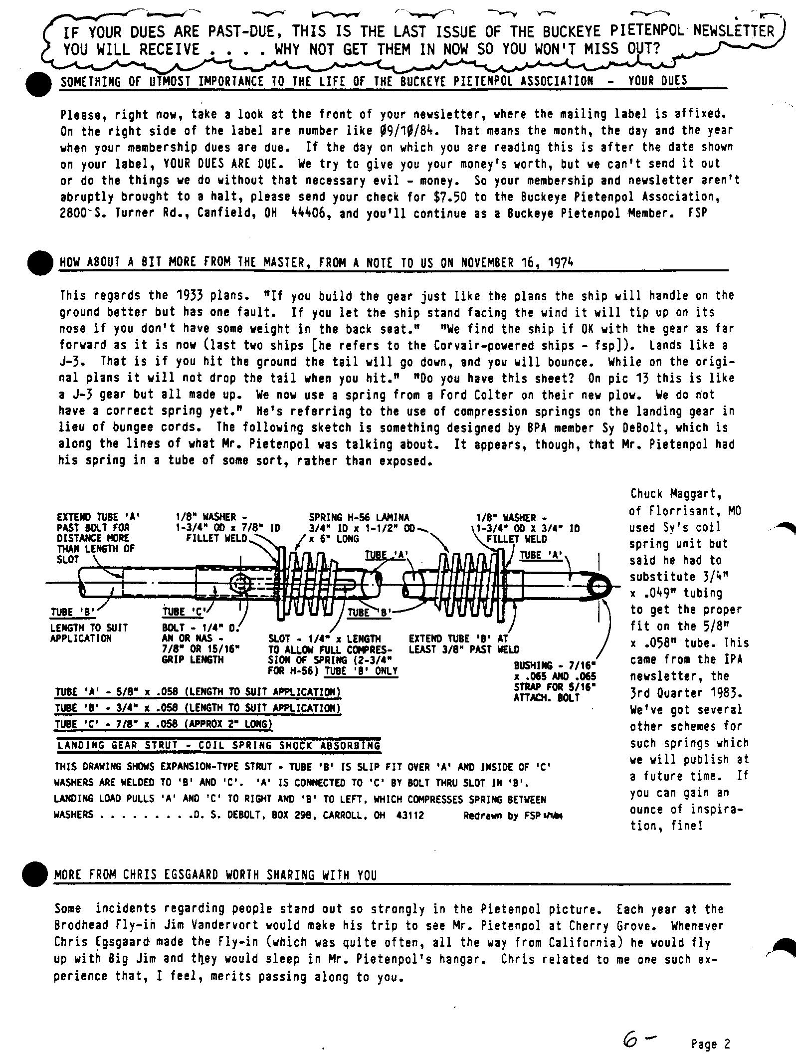

Steel Landing Gear Replace Bungee Cords With Springs Drawing
